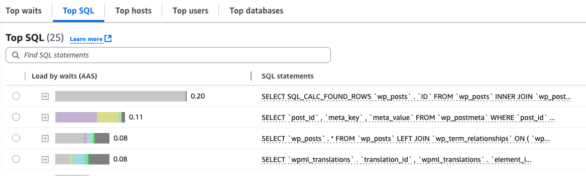

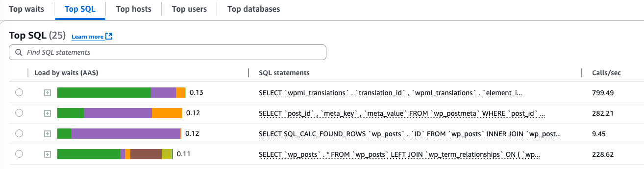

We run a high-traffic corporate website, and last week we experienced an unexpected traffic spike that caused the site to go down. Upon reviewing the SQL query logs, we noticed potential issues related to WPML.
At this stage, it’s unclear whether the problem stems from the WPML setup itself or if another plugin triggered the spike, which in turn affected WPML’s performance.
Would it be possible to invite your support team to access our website admin area to review the setup and assist with troubleshooting? I’ve attached screenshots from the time of the spike, in case they help identify any known issues. I’m also happy to provide any additional information you may need.
The site went down due to an unexpected traffic spike, and there are potential issues related to WPML observed in the SQL query logs.
