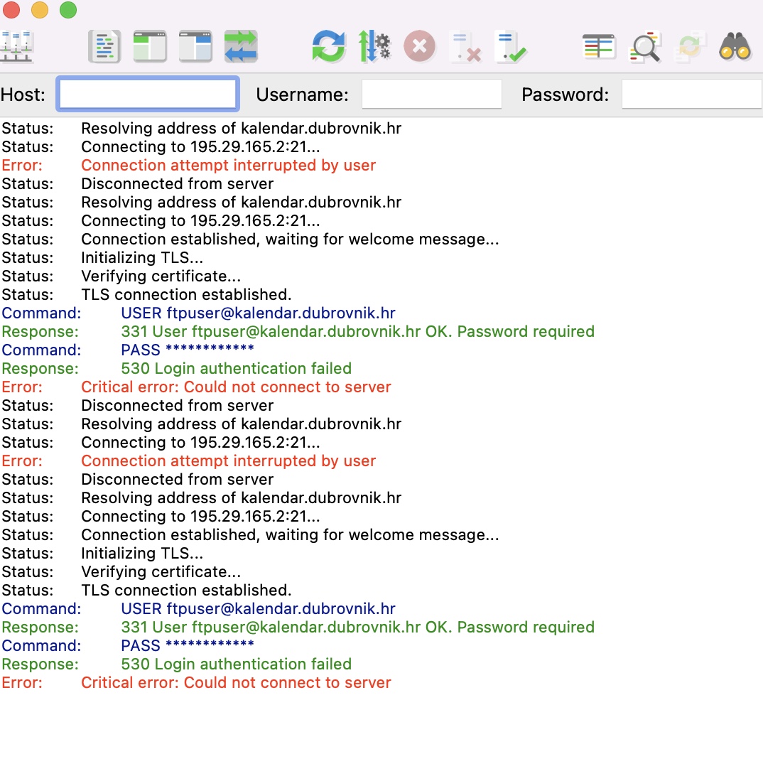

August 22, 2022 at 9:32 am #11903353
WPML Supporter since 08/2022
Thanks for your reply.
Still incorrect as shown in the attached screenshot. Maybe you forget to click "update password"?
Thanks!

August 22, 2022 at 9:40 am #11903421
stjepoH
Hi Kor,
I've changed it again with the same password and confirmed that I've updated 🙂
pass: Kl4760ZvEIv9
Please try

August 23, 2022 at 8:23 am #11909831
stjepoH
Hi Kor,
Using FileZilla I've been able to connect to ftp using same credidentials.
You have to setup in Transfer Settings-> Transfer Mode: Active
Please try this.
Thanks!
Stjepo
August 23, 2022 at 1:24 pm #11912785
Sorry, your FTP access credentials are still not working. I think this has been going on too long and I'm sorry. Please let me forward this to our 2nd Tier Support, and I'll let them check.
