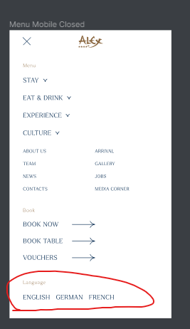

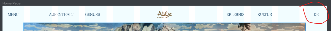

Hello, I know that I can output the custom language switcher via PHP actions. My problem is: in one place want the languages to be: EN | DE | FR and in the another place to be: English | German | French, do you know what I mean? I sent the screenshots to be as clear as possible.

Maybe the one place can be the footer language switcher where you can customize the LS to be like that and then customize the "Other language switcher" to be like the other and include it via code.
For example, the following code 'll output a kind of EN | DE | SK (as per my configured languages - see attached):
function test_ls() {
    global $sitepress;
    $testls = $sitepress->get_ls_languages();
    foreach ( $testls as $lng ) {
        echo( "<a href=" . $lng["url"] . ">" . strtoupper( $lng['code'] ) . "</a>" );
        echo ("|");
test_ls();
You can place that function in your theme's functions.php file and use test_ls() wherever you need it to display. You can also create a shortcode (hidden link) of that for the ease of use in your templates or content places.
You may also style it as needed.
In short, the whole idea is that, you can create and use one language switcher from existing options in WPML -> Languages, and code one to suite your other custom need.
