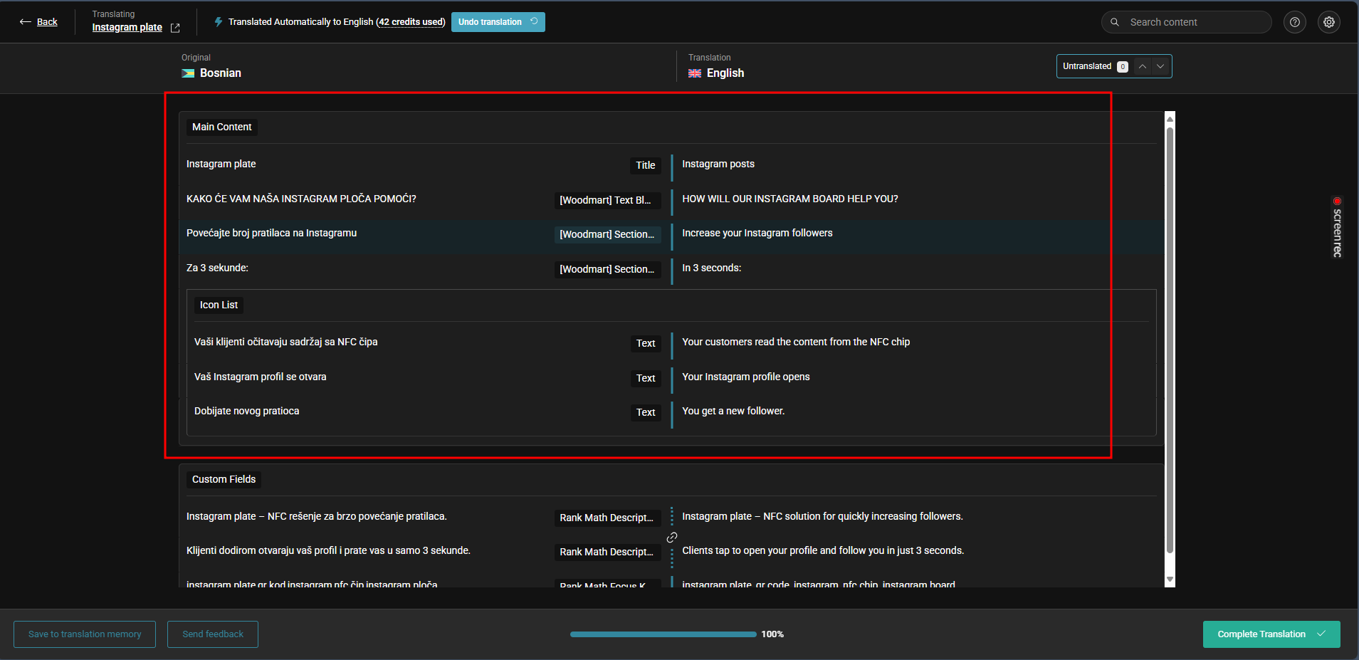

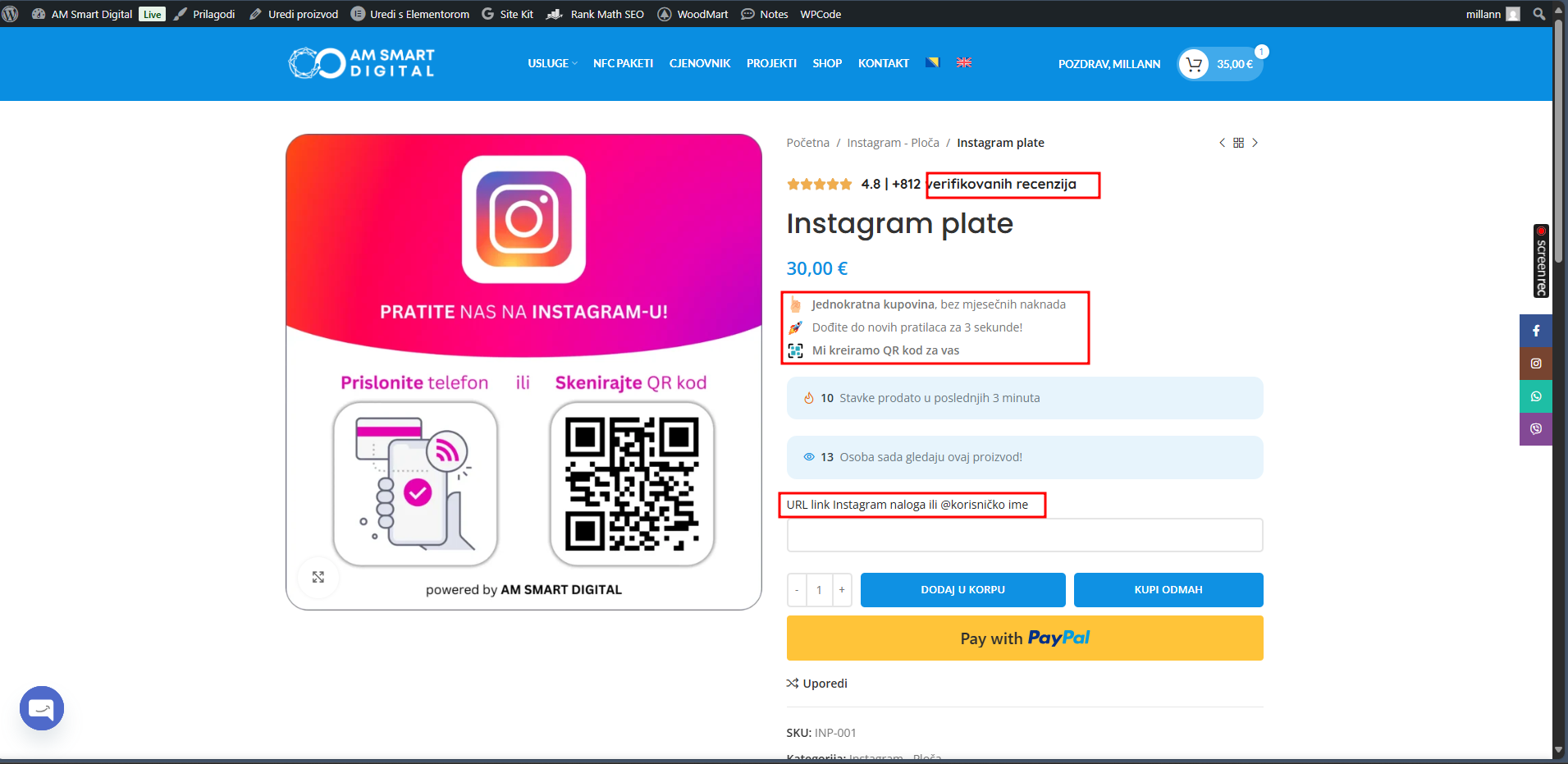

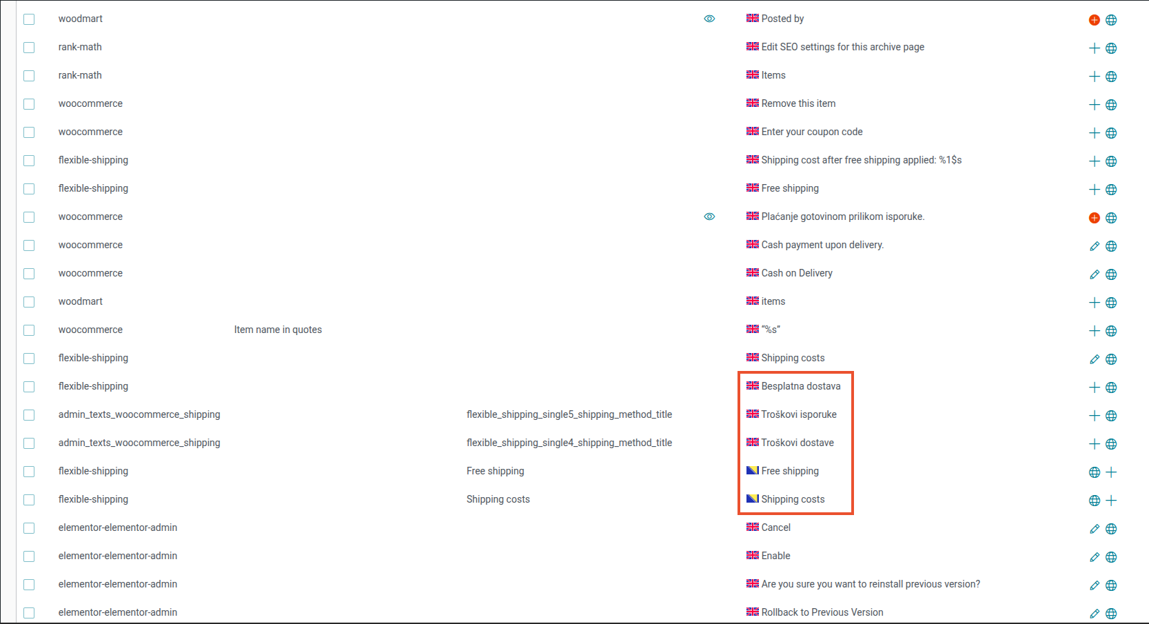

See for example this problem here, this text I've boxed in red doesn't appear in the Translate editor. Look at picture 1 and 2.
The text that is framed in red is in the Product Template and as such it is not possible to translate it through elementor and it does not appear in the Translate editor nor can I find it in any way through WPML! Watch the video. hidden link
Product Layout controls the appearance of the first part of the product where the Add to Cart button is, while the second part with tabs and descriptions is fully customizable and can be translated according to current practice using Elementor!

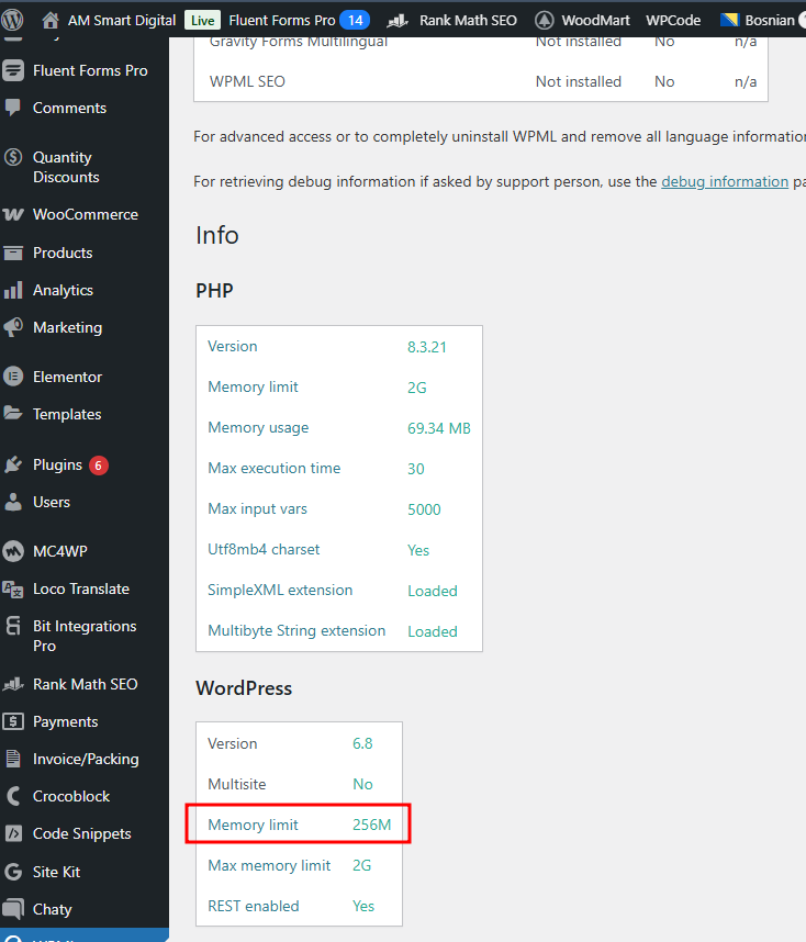

May 24, 2025 at 5:36 pm #17068956
Could you please manually check if the Woodmart Layout Display Conditions are correctly set on the translated layout?
Further, it seems the minimum requirements on the server are not met:
https://wpml.org/en/home/minimum-requirements/
Could you please increase the WordPress memory limit (WP Memory Limit) to at least 256 MB? WPML requires at least 128 MB.
Your current values ​​are:
PHP Memory Limit 2G
WP Memory Limit 40MB
To do this, you need to connect to your website's server and open the wp-config.php file in a text editor. The file is located in the WordPress root directory.
Add this code to the wp-config.php file to increase WordPress's memory:
define ('WP_MEMORY_LIMIT', '256M');
Add this just before this comment:
// That's all, stop editing! Happy blogging.
The current values ​​can be viewed under WPML > Support > WordPress.
These settings can be restricted directly by your hosting provider. Therefore, I recommend contacting them and asking them to change them directly if the changes are not applied immediately.
Andreas

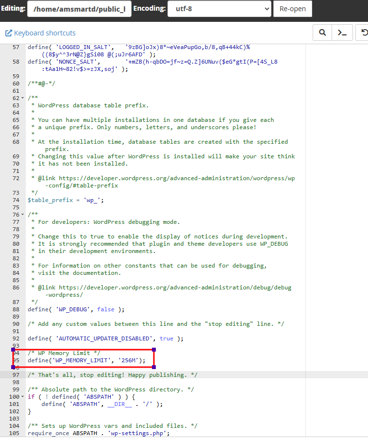

May 24, 2025 at 9:18 pm #17069159
milijanM
1. Could you please manually check if the Woodmart Layout Display Conditions are correctly set on the translated layout?
ME: And could you explain to me how to do that?
2. Further, it seems the minimum requirements on the server are not met:
PHP Memory Limit 2G
ME: I already did this part when I started communication with Noman, so I don't understand why you still see the incorrect value???
3. These settings can be restricted directly by your hosting provider. Therefore, I recommend contacting them and asking them to change them directly if the changes are not applied immediately.
ME: What does this even have to do with the fact that I can't translate parts of the text that are in the Woodmart Product Layout, I really don't understand this???
That's how Noman initially thought that the problem was in the server settings, so it turned out that the problem is in your plugin!
May 24, 2025 at 9:22 pm #17069177
milijanM
I don't think you've seen it right or we're not looking at the same parameters...

Your site does not have enough credits to run automatic translation and I am sorry to disappoint you, but our support can not create translations for you.
Until now not any of your products have been translated to 100%. The translations will need to be completed to 100% when translating for the first time to be able to see the product in a second language.
You do currently see the original product in a second language, as someone has set the "Products" in WPML > Settings > Post Type Translation to "Translatable use translation if available or fallback to default language".
If you set this setting to "Translatable only show translated items" you will only see products in a second language if they have been translated.

I don't know if you noticed, but you probably haven't, one product consists of the Layout and the other part of the product itself.
So, Layout (photo with product name, Add to Cart button and Breadcrumb)
The second part is the product itself, which contains a more detailed description, etc.
I am not able to translate the Layout completely, the elements (Breadcrumbs, product name and everything else that I marked in red)
What you are telling me has nothing to do with these things that I cannot translate!

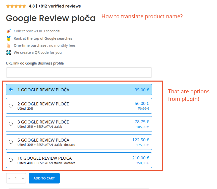

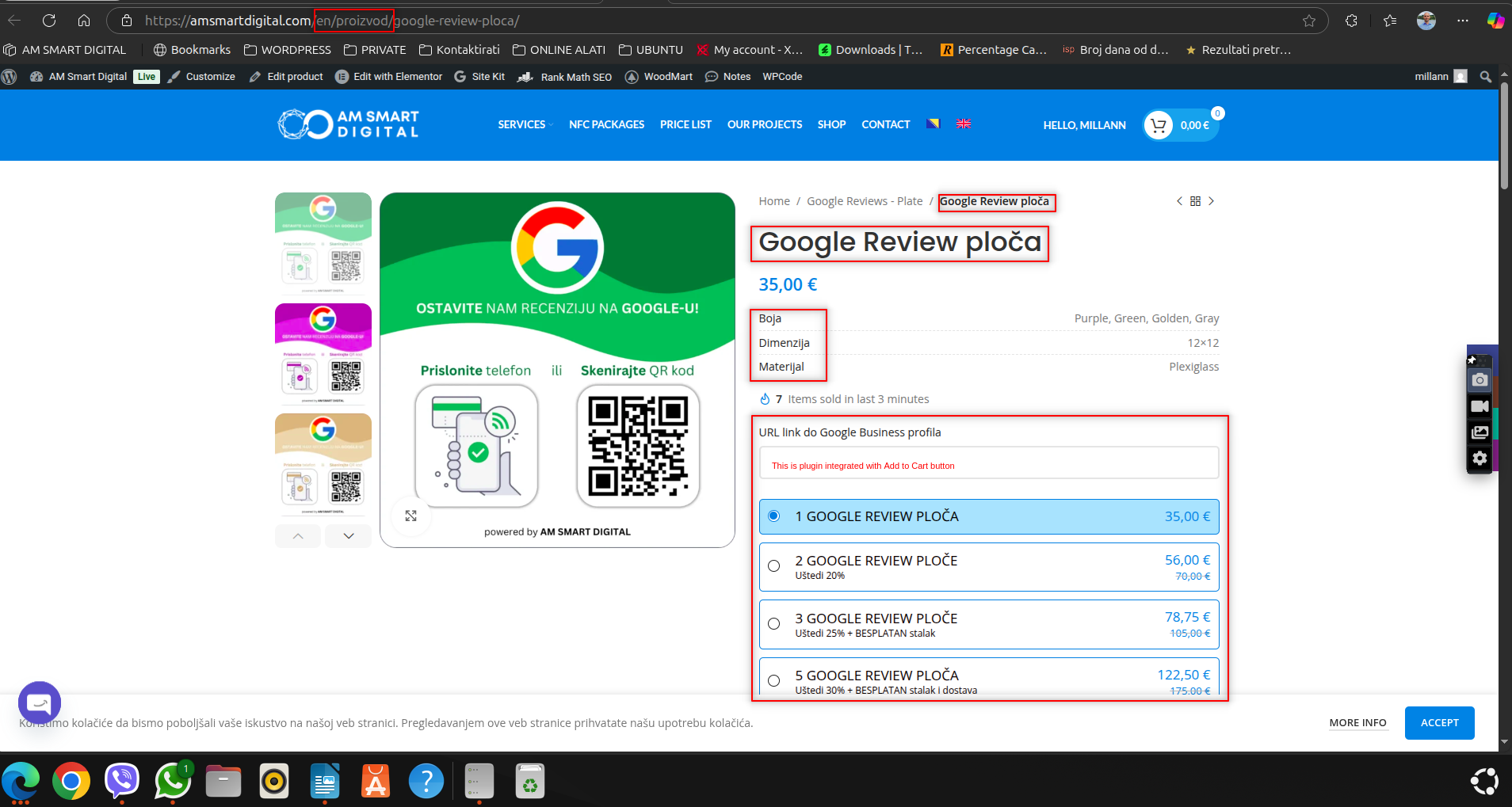

June 2, 2025 at 8:30 am #17096877
milijanM
To be honest, I am very disappointed with both the plugin and your support. I have absolutely no idea what you're talking about and I can't believe you or anyone else has a problem helping me translate Breadcrumbs, product categories, and more.
I followed the first part of the instructions you sent me through this link https://wpml.org/documentation/translating-your-contents/displaying-untranslated-content-on-pages-in-secondary-languages/#fallback-content and now everything is mixed up, what is in Serbian is English and vice versa!
If you can't resolve this I request to speak to someone higher up in support, after all this is a paid plugin and I request help translating the rest of the product! I don't care how you will do it and who will do it, if you have a problem send the ticket to Noman!
When I sent you the previous message, you did not explain to me at all how to translate the options that I get through a separate plugin and which are an integral part of the Add to Cart button. You completely ignored that!
