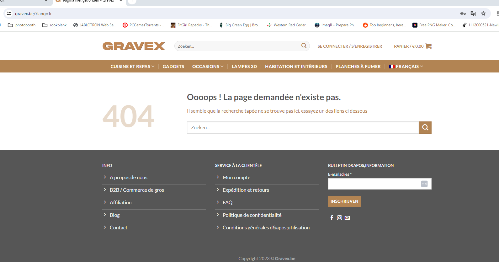

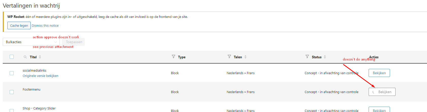

1. strange, 404 is gone. but the footer is still in original language, second menu no images, all links in the footer are also going to the first language.
see attachment, first one was wrong img. view doesnt work, I cant approve all the translations there or do something in that menu. (related to the footer menu not translated?)
Note: I won't lose credits but the spend (credit) translations are lost because I need todo everything over. Correct? so thats not an option

1.- In this case I would recommend you start from these steps:
- Create a full backup of the site
- Deactivate/pause the automatic translation
- Try to pause the ongoing translations
- Make sure you have translated the different sections of the theme following the steps described in this guide: https://wpml.org/documentation/theme-compatibility/create-multilingual-websites-using-flatsome-and-wpml/
- This guide might help you translate the links in the footer: https://wpml.org/documentation/getting-started-guide/translating-widgets/
Once you understand what part of the translation process you are stuck in (I'll be here to help you) then we will take the necessary steps to fix any issue related to WPML.
So, I kindly ask you to follow the steps I described above and let me know if you were able to solve any of the problems mentioned.

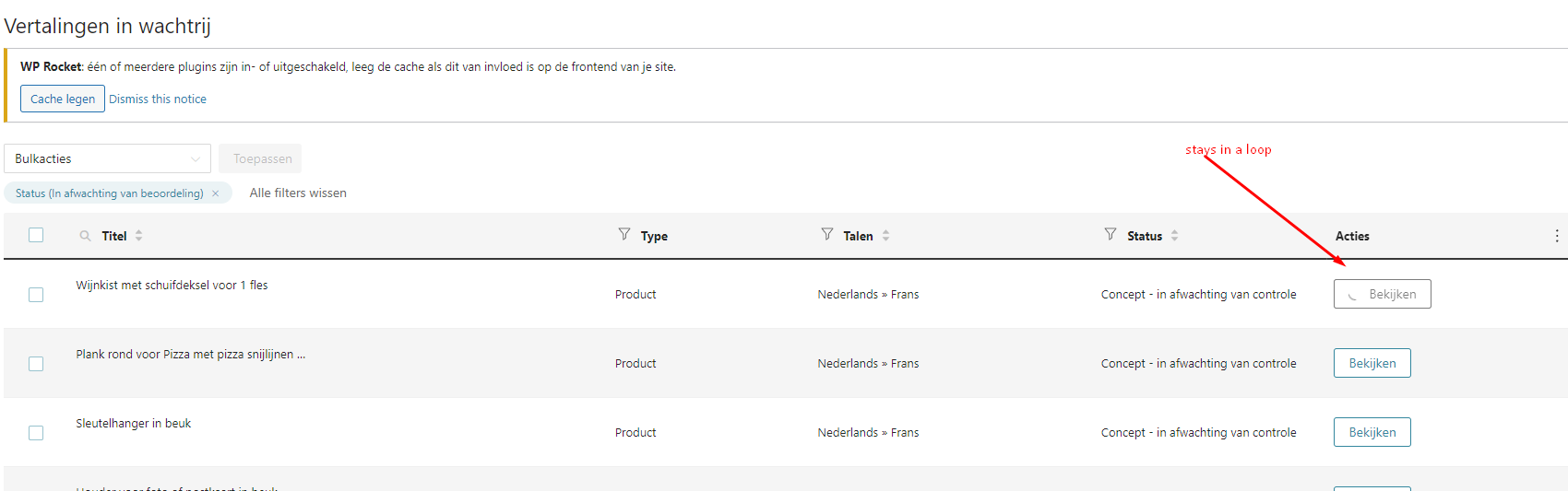

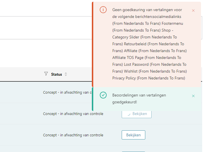

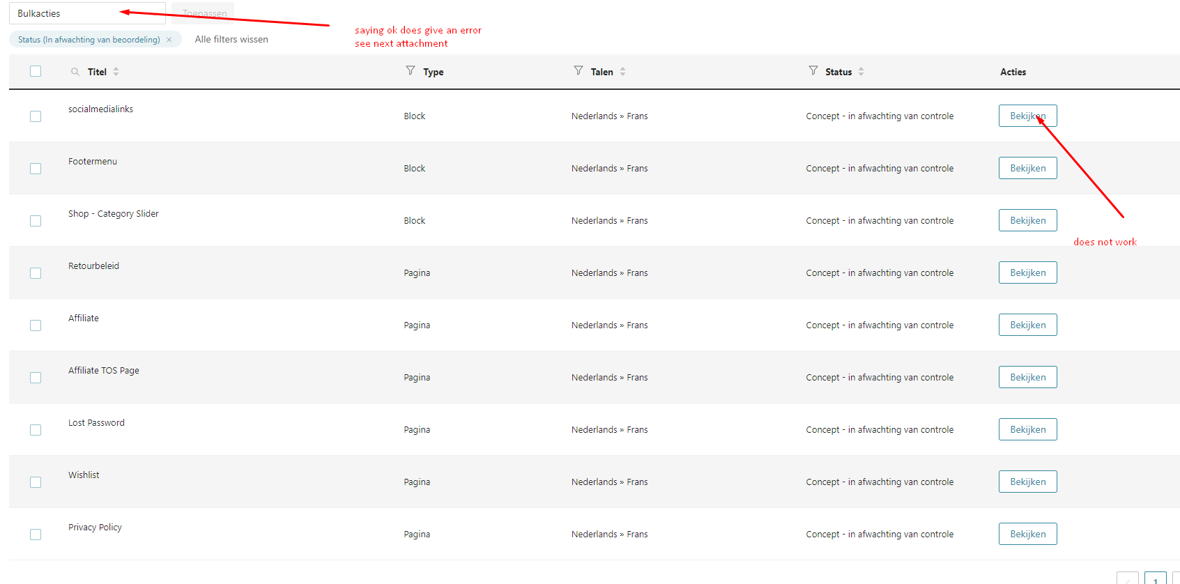

Hi checked and did some but stll the translation in the queue stay in queue even after agreeing the translation. Under action a have view but that stays in a loop see attachment.

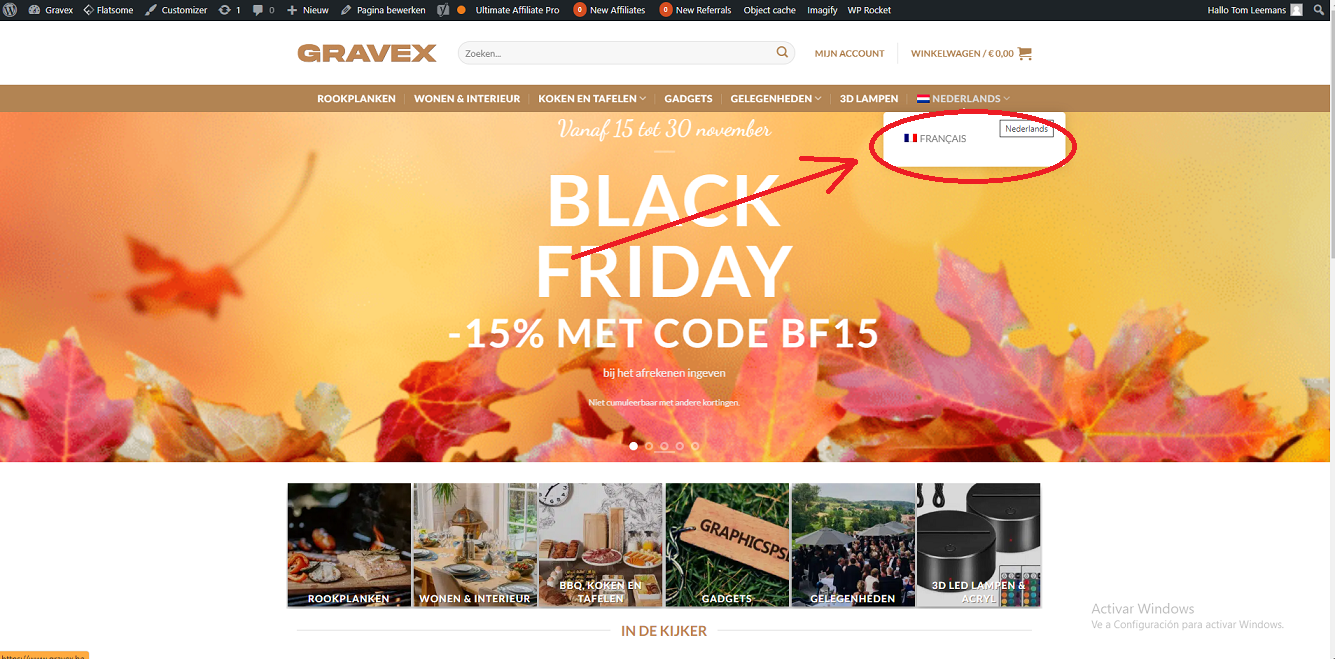

I did nothing and now the french button is away, the one in the menu and in the footer.

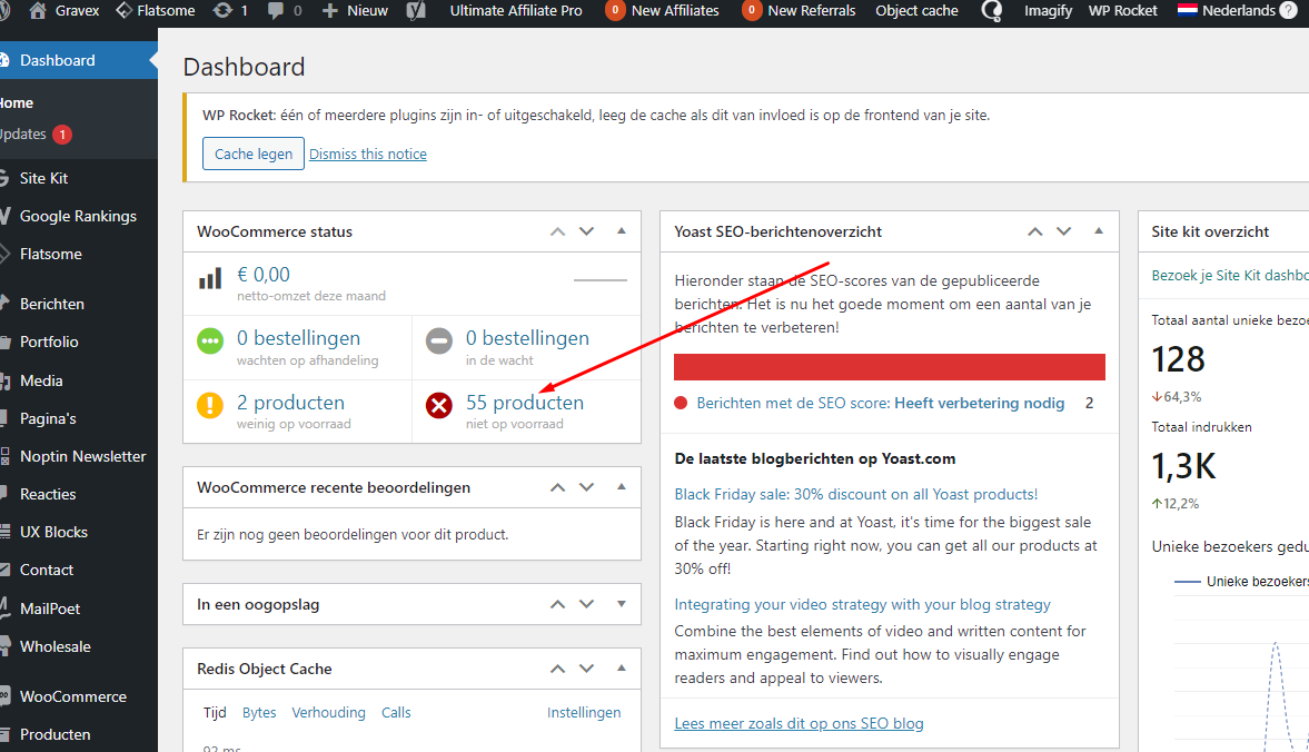

2. products out of stock is only mentioned in the dashboard: 35 product not in stock, even that everything in stock.

1.- Are you referring to the language switchers in the menu and footer? Because I can see those as shown in the attached images.

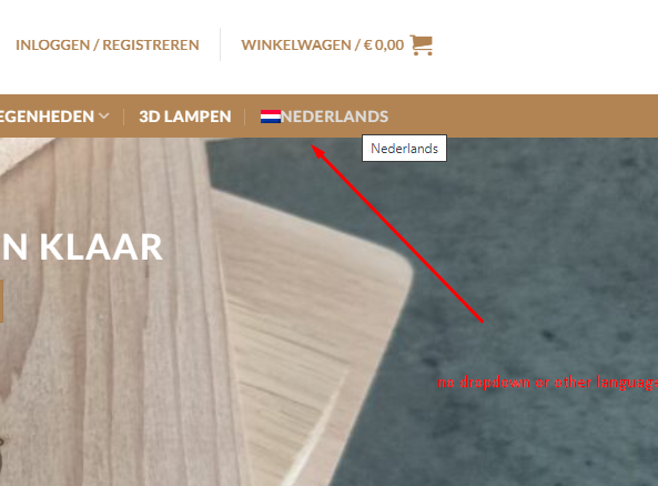

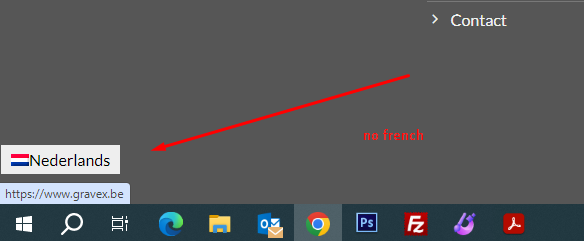

tomL-29
1. see attachment 1 and 2. on the mainpage you don't have the both languages. hidden link
if you click to another link like a category it works.
also: if you go are on a page in french and click to the mainpage (click gravex logo) you get image3
2. stock seems to be ok but not on the dashboard: see image4
