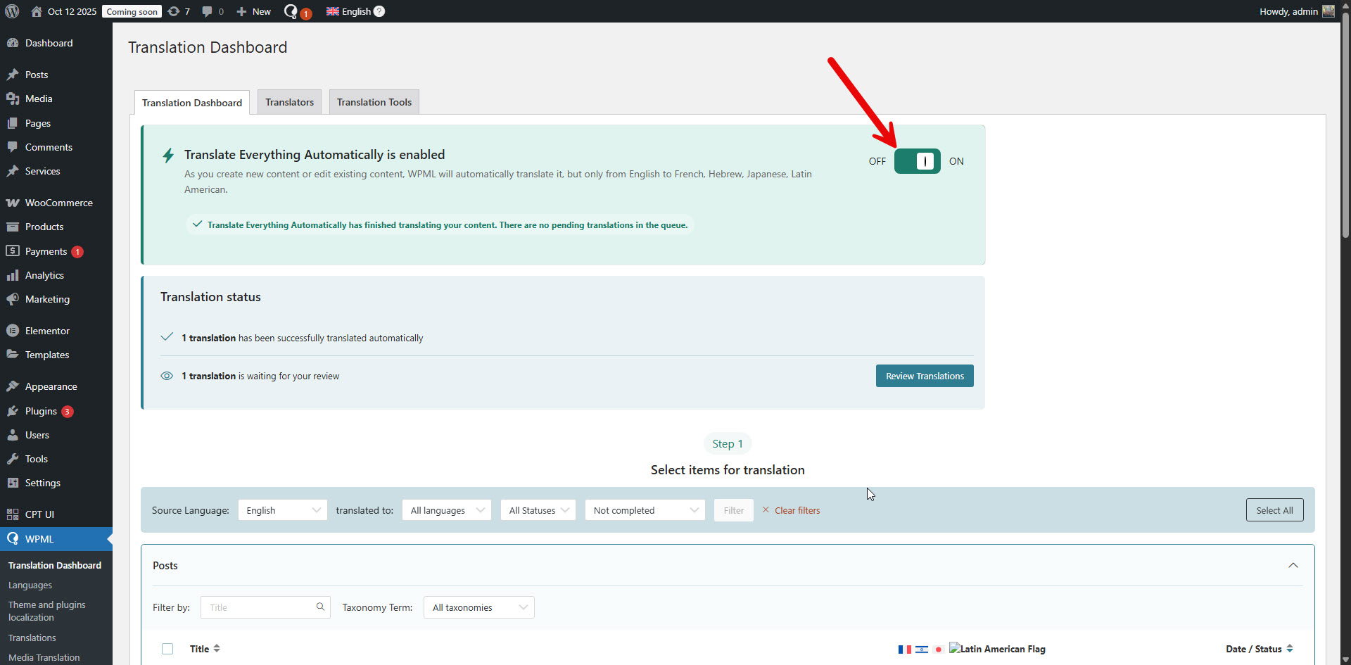

This icon informs the user about progress with automatic translation.

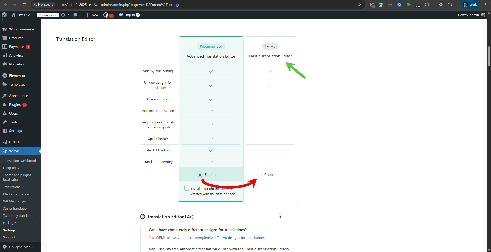

You asked: "What if we don’t want to use automatic translation and want to keep things as they were before? How can we turn off this functionality?"
I don't know how things were on your site before. But if you mean going back to using the Classic Translation Editor, you can do so in WPML -> Settings -> Translation Editor. Please see the attached screenshot cte.jpg.
Automatic translation is optional. You don't have to use it. You can still use the Advanced Translation Editor without automatically translating the content. The full settings for automatic translation are in WPML -> Settings -> automatic translation. But before going there, you should check in WPML -> Translation Dashboard, and if Translate Everything Automatically is active, turn it off. Please see the attached screenshot trans-everything-auto.jpg.

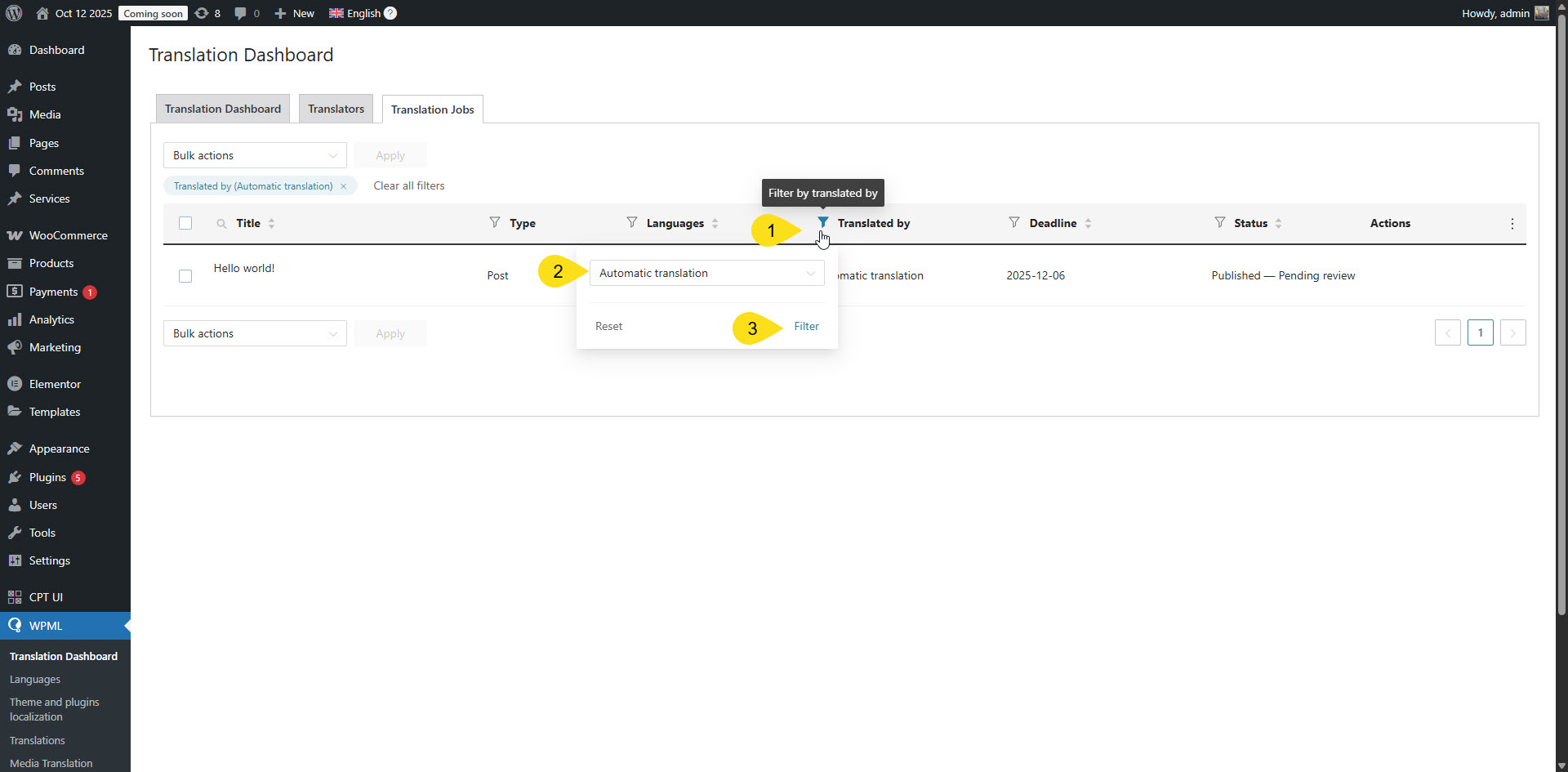

Please try the following to remove this automatic translation icon/badge.
1. Go to WPML -> Translation Dashboard -> Translation Jobs.
2. In the 'Translated by' column, filter to show translated by 'Automatic translation'. Please see the attached screenshot.
3. Select all jobs and cancel them. Please see the attached screenshot.
4. Try the following troubleshooting options.

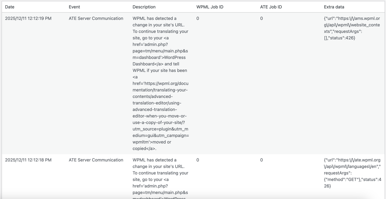

Please go to WPML -> Support -> Advanced Translation Editor - Error Logs.
It should be on your site: hidden link.
There are probably errors there.
Please copy and paste here the most recent errors.

on the prod site we in Advanced Translation Editor - Error Logs we don't have any recent logs, but on the dev we have some of them:
2025/12/11 12:12:19 PM ATE Server Communication WPML has detected a change in your site's URL. To continue translating your site, go to your hidden link and tell WPML if your site has been moved or copied. 0 0 {"url":"https:\/\/ams.wpml.org\/api\/wpml\/website_contexts","requestArgs":[],"status":426}
2025/12/11 12:12:18 PM ATE Server Communication WPML has detected a change in your site's URL. To continue translating your site, go to your hidden link and tell WPML if your site has been moved or copied. 0 0 {"url":"https:\/\/ate.wpml.org\/api\/wpml\/languages\/en","requestArgs":{"method":"GET"},"status":426}
2025/12/11 12:12:18 PM ATE Server Communication WPML has detected a change in your site's URL. To continue translating your site, go to your hidden link and tell WPML if your site has been moved or copied. 0 0 {"url":"https:\/\/ate.wpml.org\/api\/wpml\/languages\/check_pairs","requestArgs":{"method":"POST","body":[{"source_language":"en","target_languages":["en","en-ca","en-gb","fr"]}]},"extraMessage":"WPML Failed to check language pairs","status":426}

The recent messages you show in hidden link are related to this guide.
https://wpml.org/documentation/translating-your-contents/advanced-translation-editor/using-advanced-translation-editor-when-you-move-or-use-a-copy-of-your-site/.
Please check the guide to ensure that the site has been successfully migrated into the dev environment.
