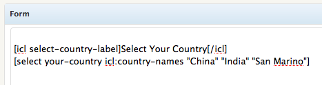

In order to change make text that’s outside of field names multilingual (any other text in the form), wrap it in an [icl] tag.
For example, supposing we’re translating the label for the country name selector:
Select Your Country
Wrap the text that needs to be translated with [icl] and [/icl] tags:
[icl]Select Your Country[/icl]
Like in the previous example, let’s also add the string context to the translation tag.
[icl select-country-label]Select Your Country[/icl]
The result of what we just did appears below. This is a contact form (or at least part of it), which will appear fully multilingual to visitors.
Multilingual contact form
