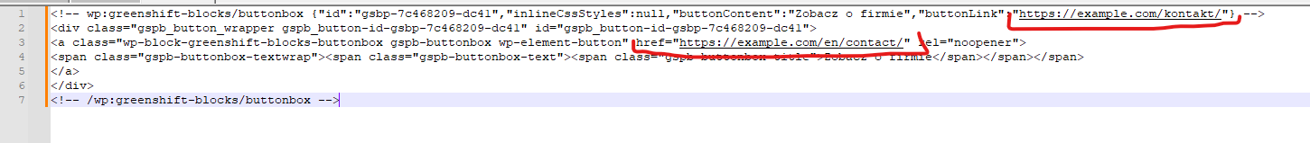

When duplicating content to a new language, it changes the link in the href but does not change the url in the custom gutenberg block(e.g. example.com/kontakt turns into example.com/en/contact). Unfortunately, this causes an error in the block (inconsistent data). Is it possible to force WPML to also change the url in a custom block or disable the automatic change in the href?

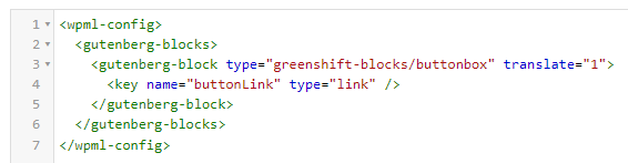

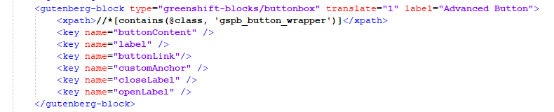

I tried adding in wpml-config but it doesn't work for duplication.

The problem is not the slug translation(it is generated correctly).
The problem is with the content of posts and pages.
When I copy a page to another language, the links in the content are automatically replaced, but they are not changed in the gutenberg block attributes.
Changing "WPML → Settings → Translated documents options" does not change the way the link is replaced in the content
Using "WPML -> Settings -> Translate Link Targets" change url in
but
"buttonLink":"hidden link" didn't change to "buttonLink":"hidden link"

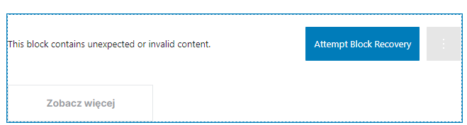

I was able to observe the problem by trying different things. I observed that the problem isn't with WPML but coming from "GreenShift - Animation and Page Builder Blocks" plugin itself.
For example, this page hidden link, if you see that button's URL is pointing to correct English version of Kontakt page, while if you edit this page, you'll see the block is broken.
Proof of concept:
- Create a new page with that GreenShift ButtonBox block, in default (Polish) language.
- Set a URL to "Kontakt" page (i.e. hidden link).
- Publish the page.

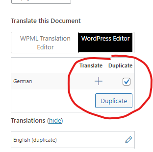

- Click "duplicate" in Languages section and duplicate the page to English.
- Edit the English translation (duplicated in previous step).
--- (Optional) Click "Translate Independently" in Languages section.
- Make any change to the page, except the block which looks broken.
- Save the page.
- Check on frontend, that button has correct URL to English version of the Kontakt page (hidden link).
- However, if you attempt to recover the block, it recovers fine. But of course, you've to adjust the link by yourself.
In short, WPML does its work correctly. But it is the block which becomes corrupt. This is a compatibility problem and you may check with plugin author for a compatibility update. Because this plugin isn't on our compatibility list (https://wpml.org/plugin/?wpv_view_count=120064&wpv-plugin-functionality=0&wpv_post_search=GreenShift&wpv-wpcf-recommendation-flag=&wpv_filter_submit=Search).

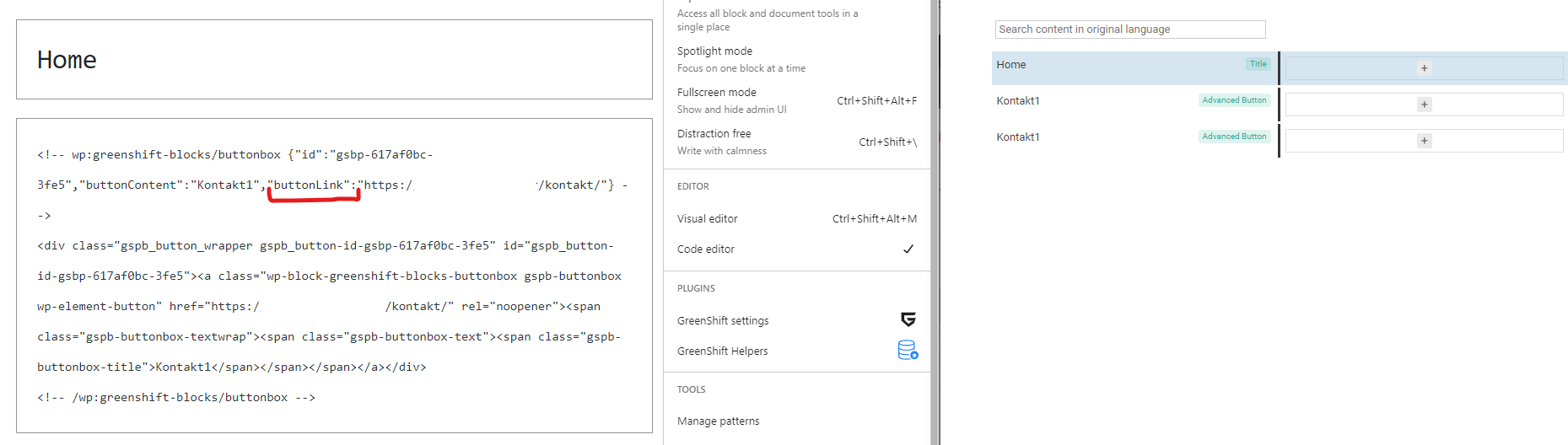

Block becomes corruptet because WPML don't see key "buttonLink" in block and didn't translate it but WPML see link in

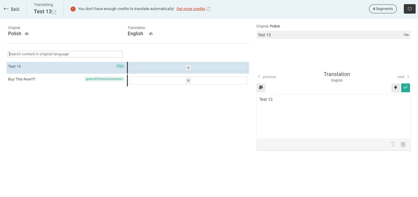

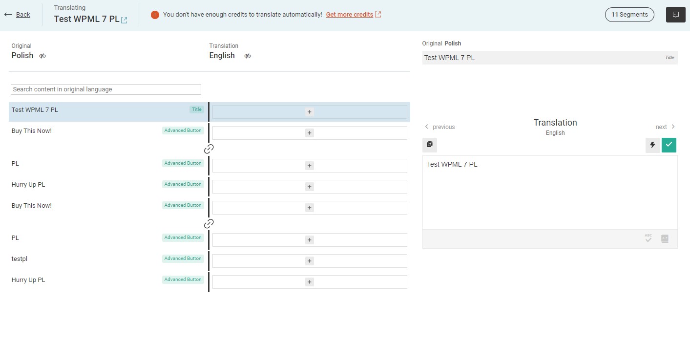

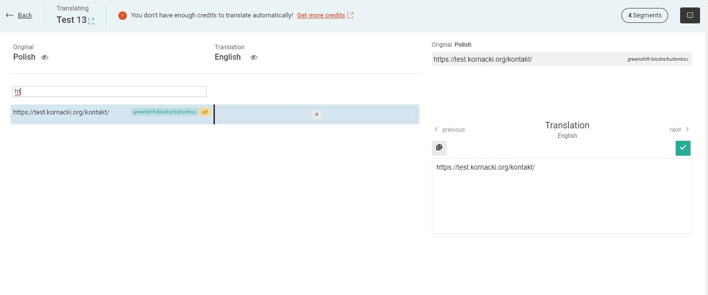

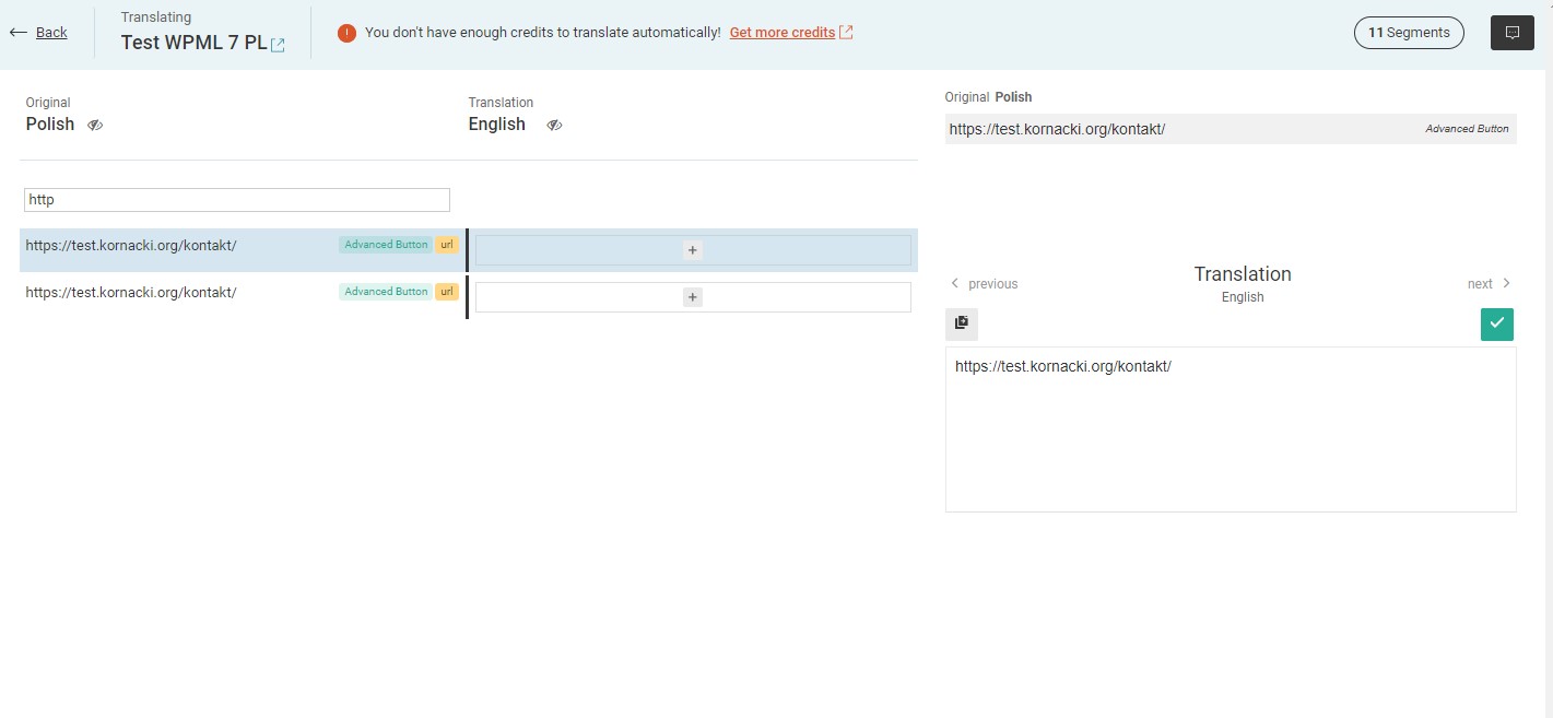

I tested again in your site and I am still convinced that problem is with custom block's scaffold. I followed this guide for examples https://wpml.org/documentation/support/language-configuration-files/make-custom-gutenberg-blocks-translatable/ and compared your block's scaffold also. Perhaps you need to check according to these lines.
Because I removed the XML from wpml-config.xml from plugin's folder and block is still corrupted when switched to other language (i.e. duplicating the post).

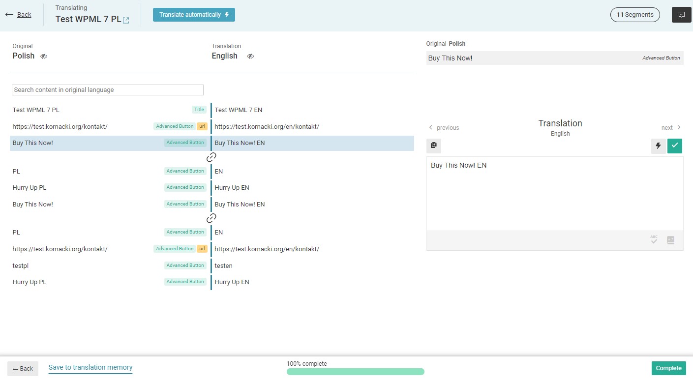

Another proof of concept is that, if you see the code of corrupted block, the A's href attribute contains translated link already - check this screencast: hidden link
While, in ATE, all the attributes look just fine. I tested this with your XML added to the config, as well as, without the XML (see attached).
For the links, which are by default not visible in ATE, you have to search for http or https to find these links for translation.
