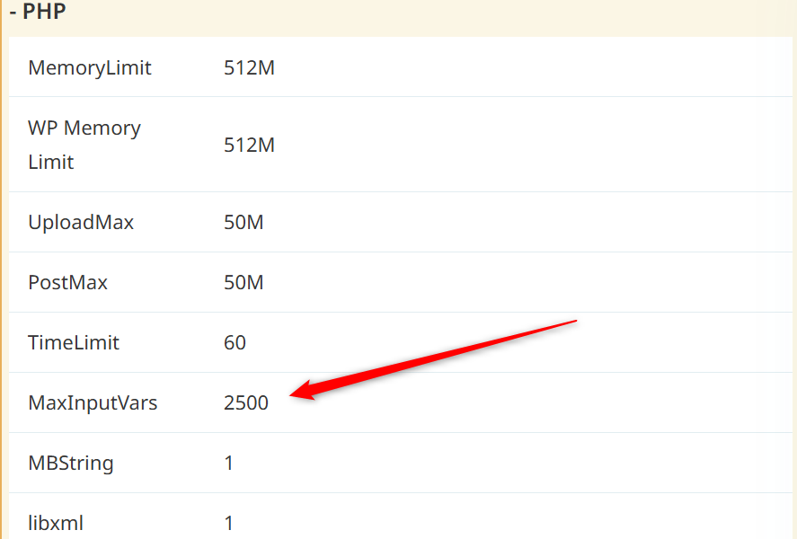

These settings are not the issue.
Indeed, you have access to staging, which is limited.
My original site has the settings you mention (see image), and it does not change, status is identical.
I am even more sure that it's not an issue of memory or calculations, that I duplicated this post, cut it in 4 different pieces, and it does change anything as well. For any of the 4 sections.

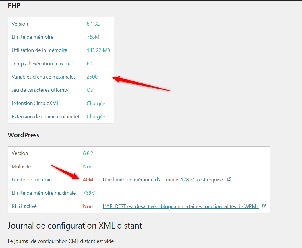

Thank you for the details. I hope your live site is also hosted on Cloudways.
This may be a compatibility conflict. I will continue testing this further. Just to confirm, were these tests performed on the same staging site or the live site? If so, please share the post URLs.
Also, have you tried using WPML's Advanced Translation Editor? It is much easier to manage and offers several helpful features, such as Translation Memory, which can save time by automatically reusing previously translated content.

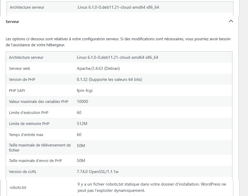

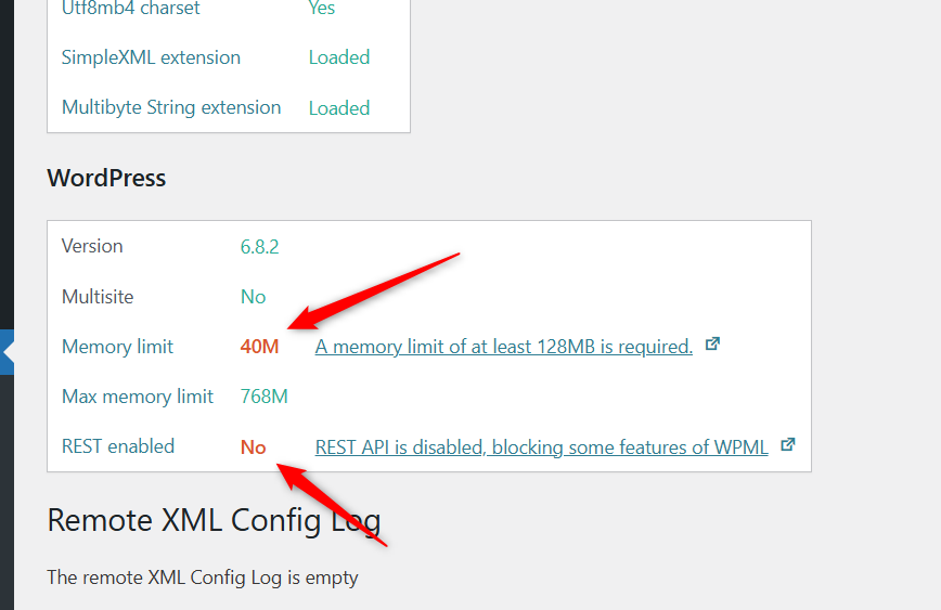

Additionally, as per the Debug Information, the max_input_vars value on your live site appears to be set to 2500. You can verify this by visiting WPML >> Support >> PHP Info.
Therefore, could you please recheck and confirm? Because when translating long posts or working with WooCommerce products, it is highly recommended to set max_input_vars to at least 10000. This ensures that all fields are processed correctly during translation.

You were most certainly right, if the settings on my Cloudways interface seemed right for my site, they were probably not implemented ... thank you for noticing it. I questioned the Cloudways team, and now, it's rectified and apprearing on WP/Tools/Information, it's image max input vars.

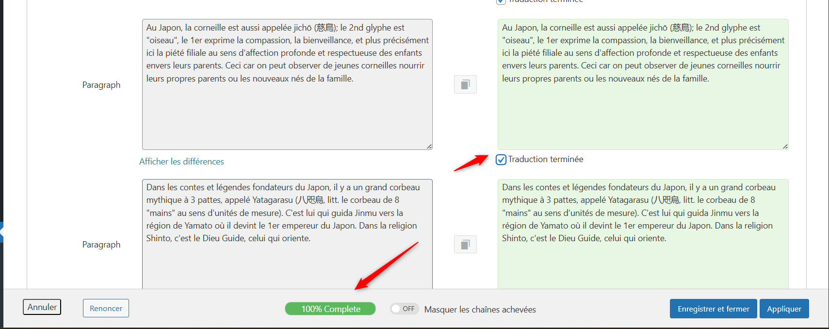

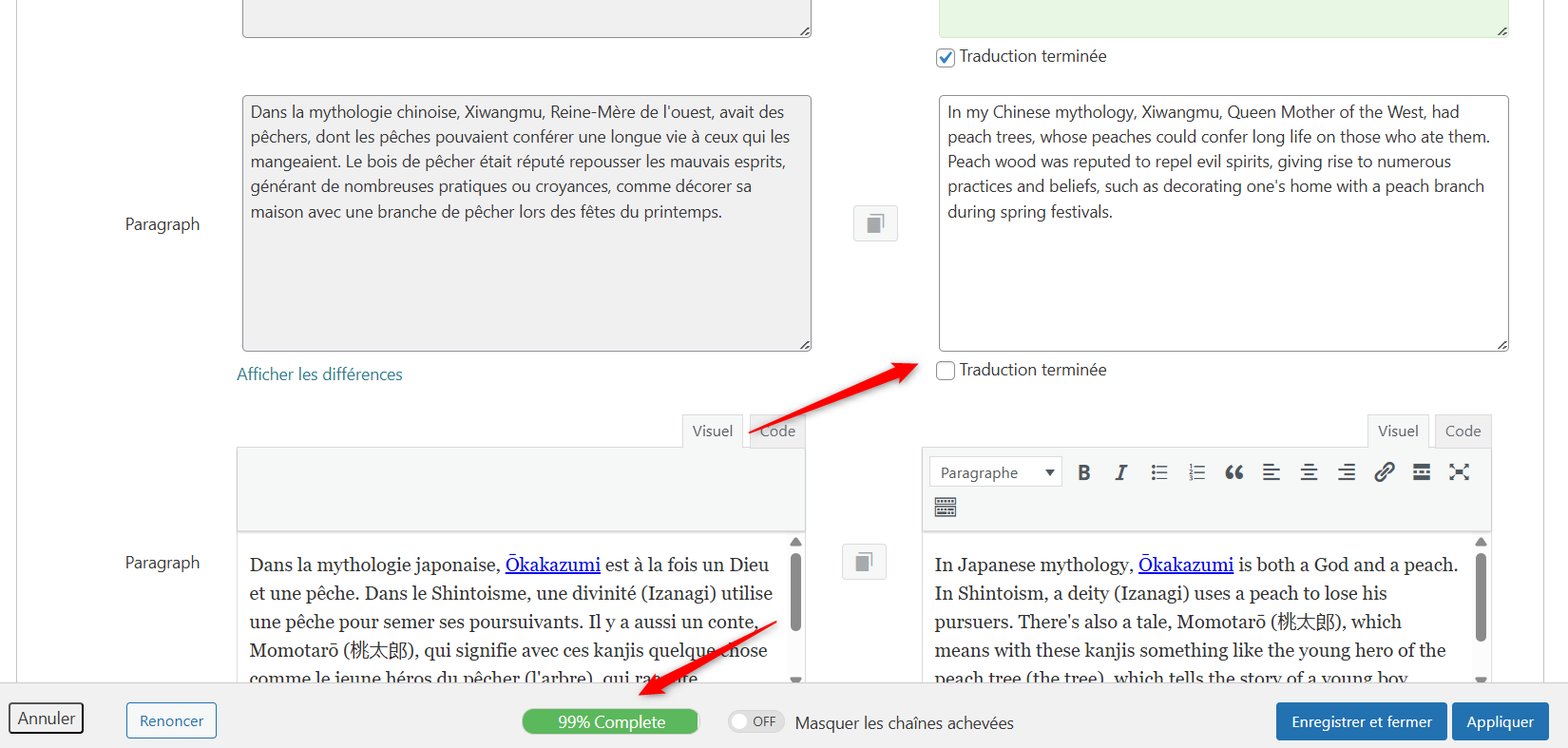

Following this change, I tried again to translate the post.
What is the result?

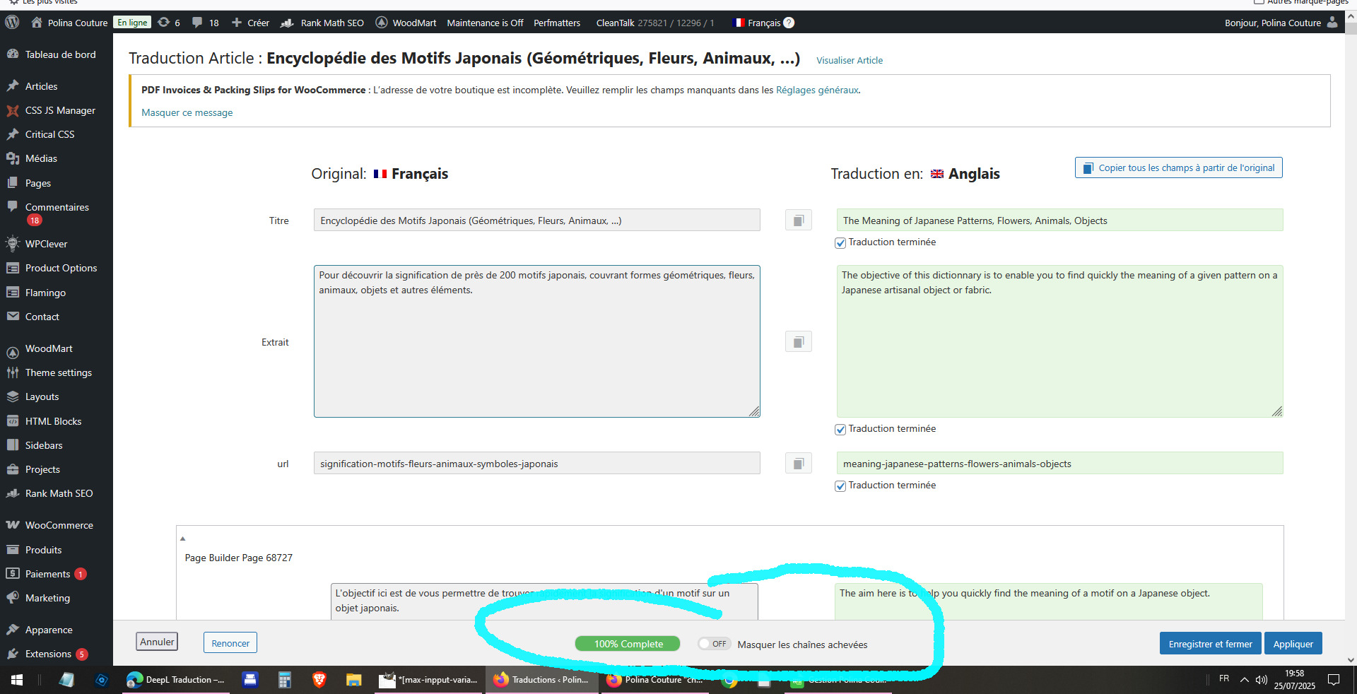

- as far as I can see, I can translate all fields / paragraphs.

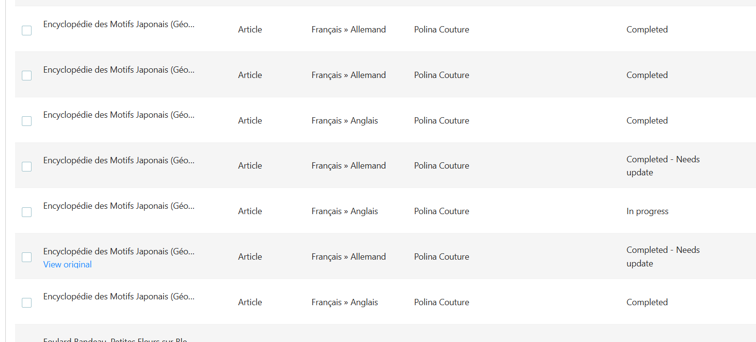

- when I save, the saving can't be completed, the hour glass remains for hours ...
- when I later look at wp/articles, the given article is declared as 'under way", that's your clock wheel (see image uncompleted)
- surprisingly, when I open the translation (EN), it's declared as 100% completed (that's image though-completed)
- when I look at article in EN, well, whatever declared as translated or not, and anyway though 100% translated in WPML editor, the post remains at it was before (see faisan / pheasant, translated in WPML editor but invisible in EN post). Or see coeur saignant / bleeding heart flower, which remains in former string version.

Thank you for the feedback. I checked WPML >> Translation Management >> Translation Jobs, and the affected posts' translations are showing as "Completed" or "Completed – Needs update". Please refer to the attached images for more details.
Therefore, one request. Please try the following steps, preferably with the assistance of your hosting support:

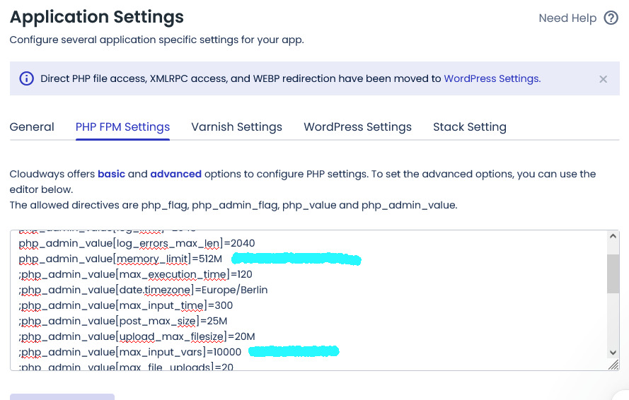

July 28, 2025 at 9:28 am #17274354
alinam-2
Hi Bigul,
Rest Api works and is not disabled via any plugin

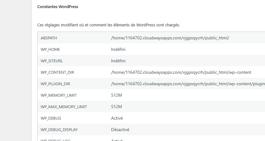

WP memory is already at 512 (see image attached). I even tried yesterday with 700. Exceed memory limit may be a symptom, like fever, but the symptom is not the illness ... hundreds of reason to have a fever.
That's what I call: shooting the ball in another field.

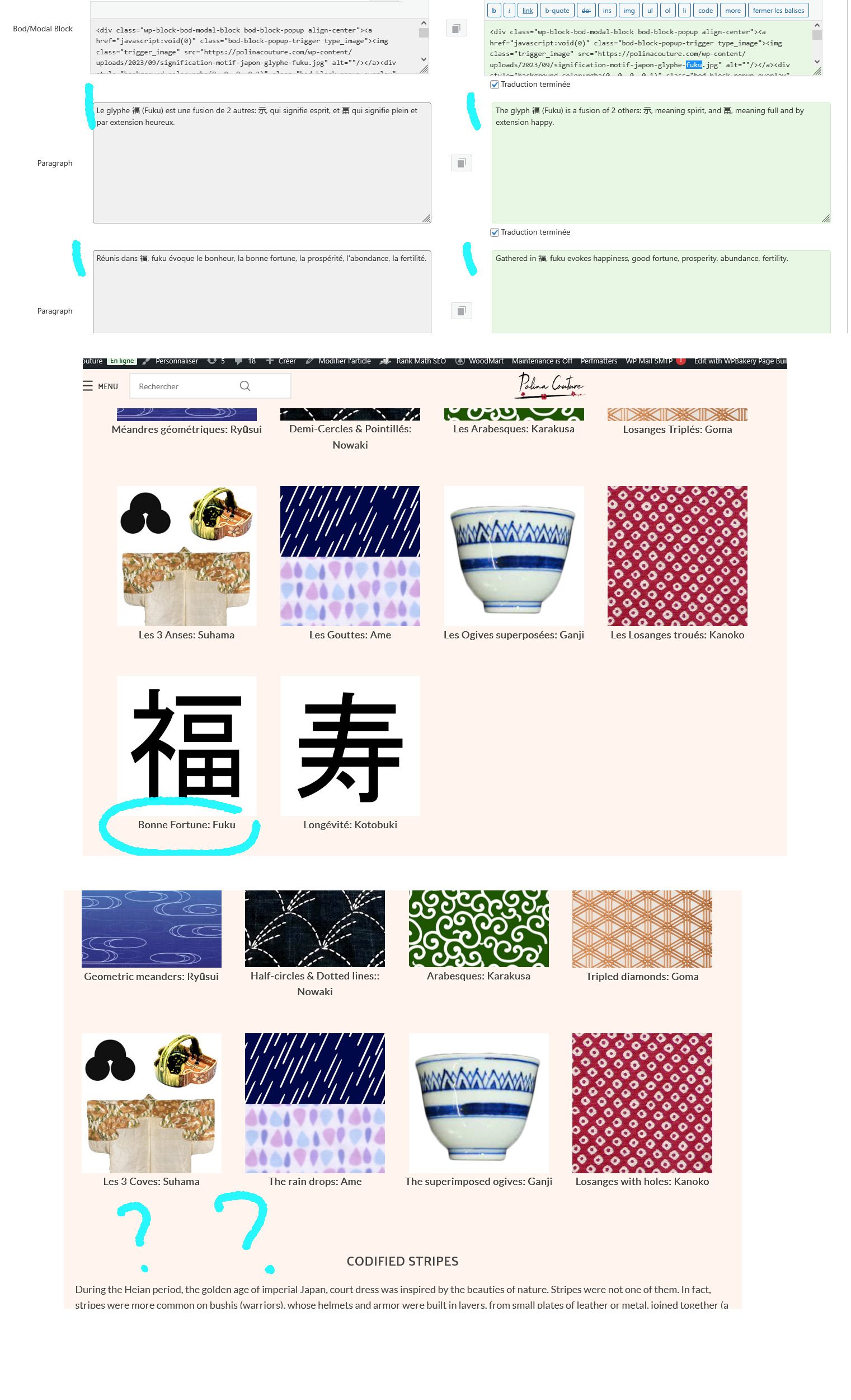

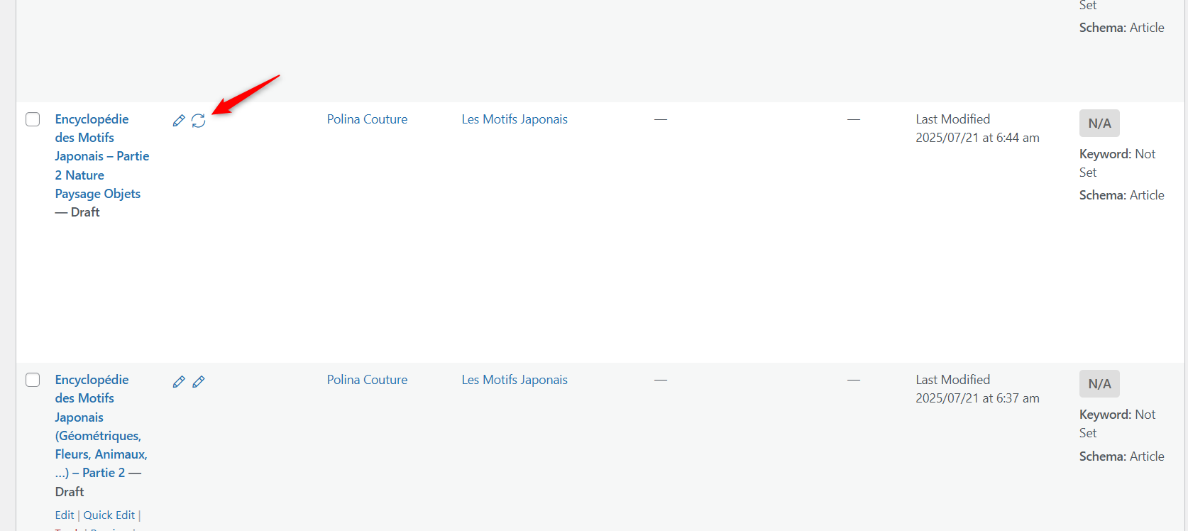

To sum it, the published post 68727:
- is translated in EN
- but the translations are not appearing in post
See image: published-post-68727-translations-made-but-missing

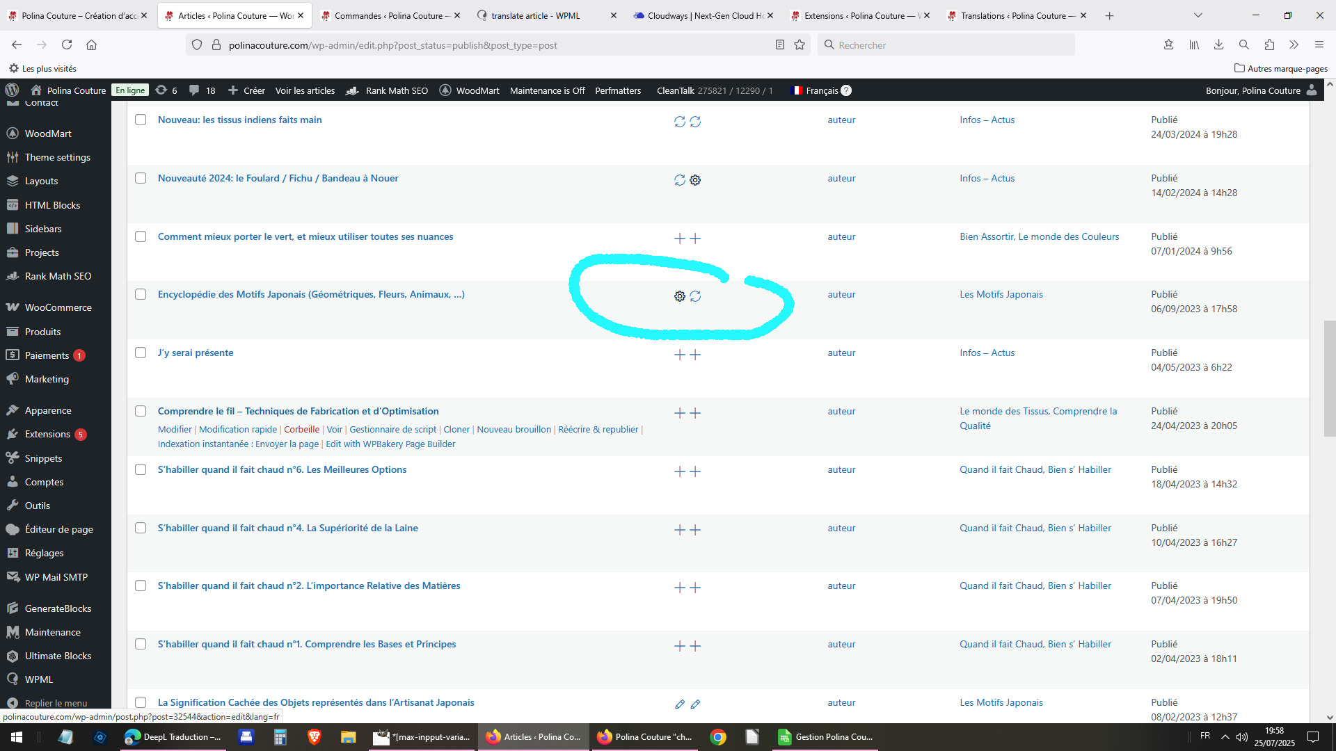

Now, it's interesting to look at post (n° 88414) just above the published one, filtered via using word ""encyclopedie" in FR ... which is at draft stage:
see image post-list-sorted-in-fr-via-key word-encyclopedie
It was generated via using plugin Yoast duplicate post.
Though identical to original one, it's declared as fully translated. What is not normal.
If you compare 88414 (FR) preview, with it's 88415 EN translatio, you see what was visually missing in original EN post is now visible (though in FR to be translated in EN). This means that the Yoast copy is better than WPML copy.
See image copy-fr-vs-copy-en-via-yoast
Of course, after, if I try to translate this duplicated post via WPML editor, it does not save. But at least, I have a better basis if I use gutenberg since the html and shortcodes are already there:
Re WPML and the problem of memory ... it's always the same process of those undefined array key on media translatin ... and then the more or less fatal error via class-wpdb.php, as as managed by WPML
See image wp-debug-log
Knowing that it follows:
parse_str(): Input variables exceeded 2500. To increase the limit change max_input_vars in php.ini. in /home/1164702.cloudwaysapps.com/vjgpsqycrh/public_html/wp-content/plugins/sitepress-multilingual-cms/classes/editor/ClassicEditorActions.php on line 20

3. max_input_vars is set at 10,000. You have the screenshot. Btw, I also increased the capability of Apache server

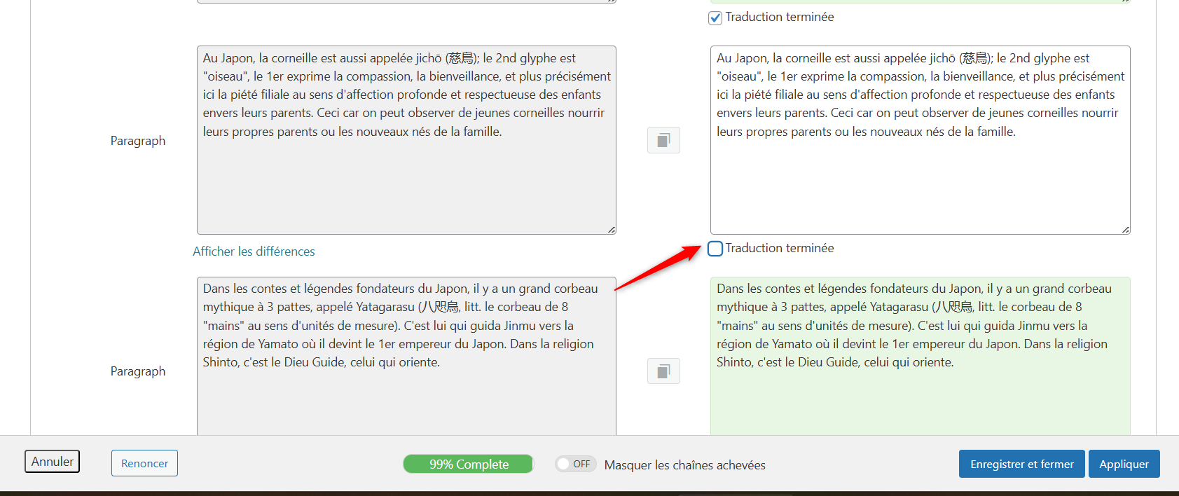

Some old translations have been "broken" by WPML changes. I found out 3 different cases:
- when paragraph was containing a link
- when paragraph had bold (ie
- and apparently also when paragraph contained quotation marks
Also, the translations that were in the past recorded and thus re-usable, are not anymore.

Hi Bigul,
For some reasons, I could work on my site for a while.
Now, I have time, and I discover several issues with WPML!
I just did a translation of a post .... the html ... indeed the gutenberg codes are badly transferred.
I wanted to update a product, it directly opens in wordpress editor, and shows: "Warning: You are about to edit your translation using the standard WordPress editor but your site is configured to use the WPML Translation Editor. Any edits you do here will be lost if you later open it in the WPML Translation Editor. "
I use the WPML eidtor, I can't anymore, and I get warnings !
Nightmare !
Kind regards
