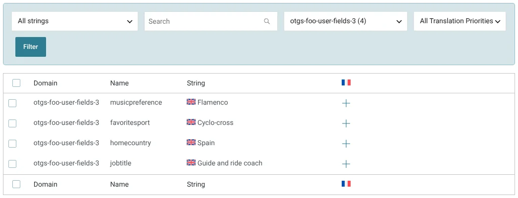

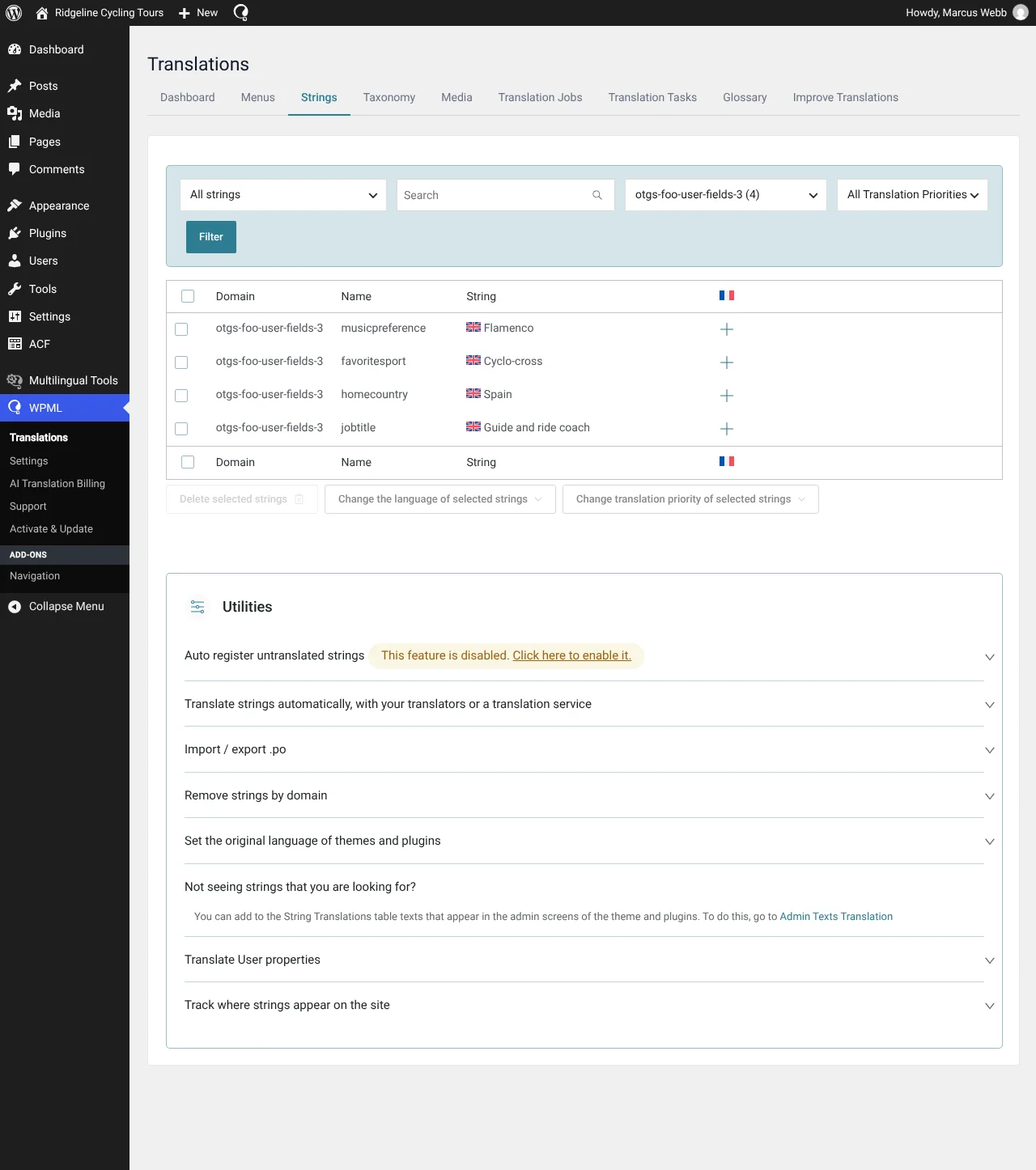

Without a string package
The four fields as separate strings, on WPML → Translations → Strings
Users need to translate strings one-by-one, without the option of automatic translation.

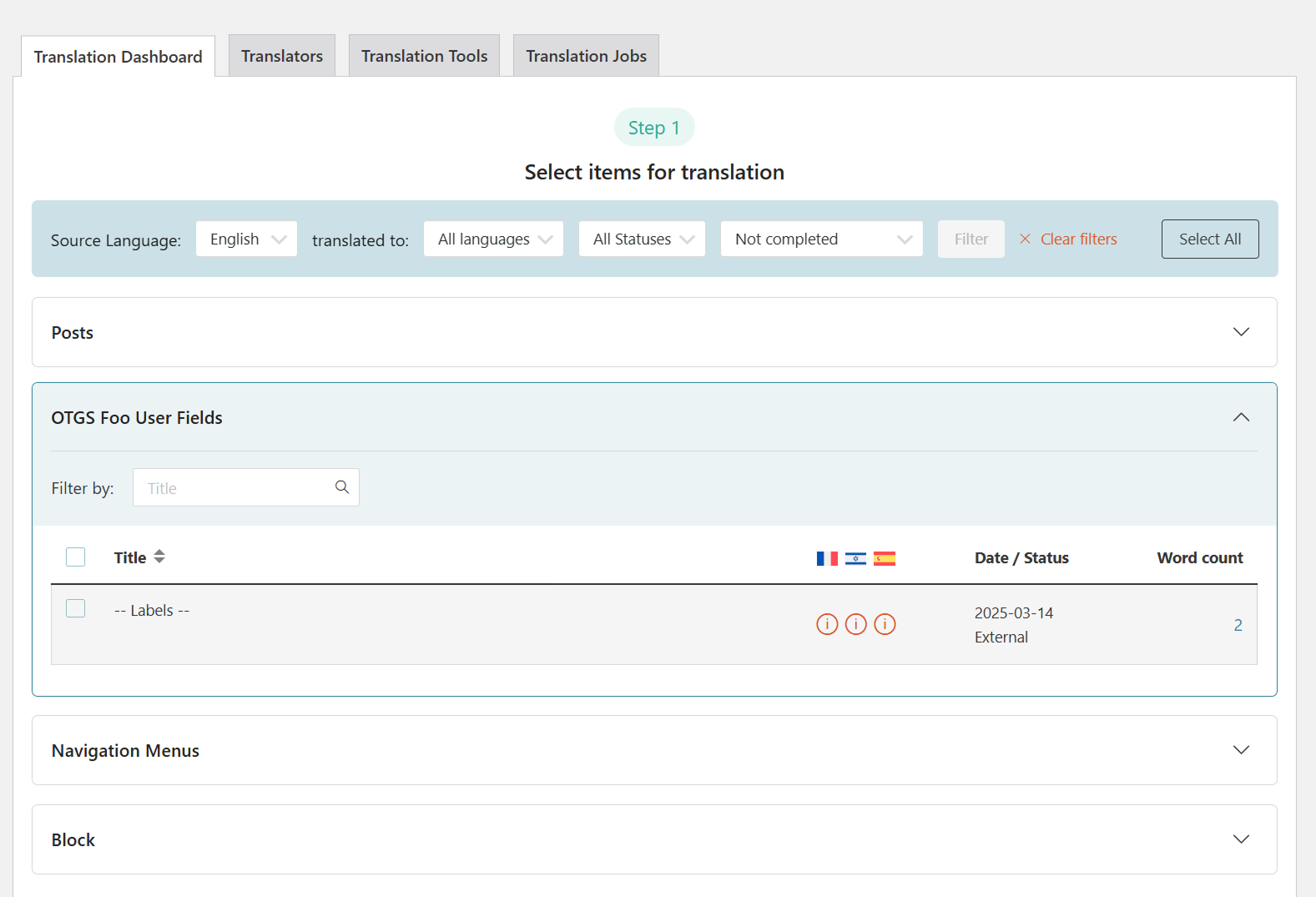

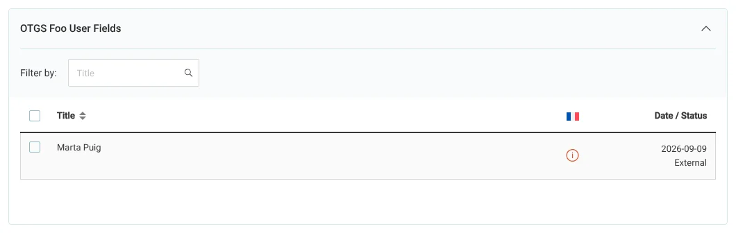

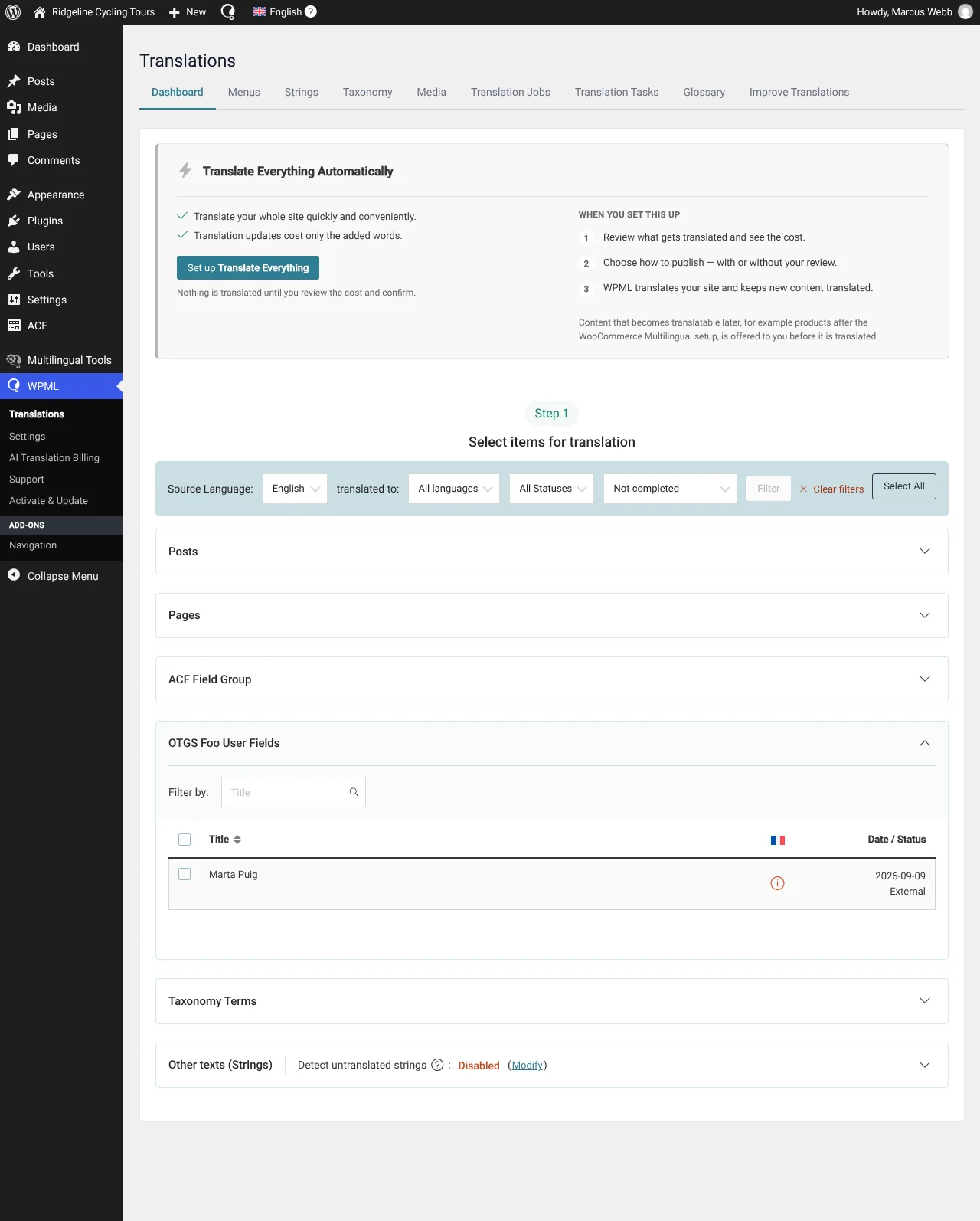

With a string package
The same four fields as one package, on the Translations dashboard
Users can translate multiple strings together in one go, with the option of automatic translation.
As you can see, string packages simplify the translation process by letting users translate multiple custom user fields at once. To provide your users with the best translation experience, follow the steps below to create your own string packages.
