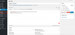

Before starting a translation, there are a few settings to check. So, Create a new job listing and Publish it.
Using WPML with WP job manager
Publishing the page

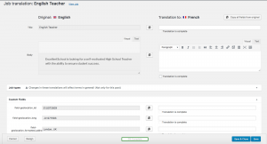

7. The Translation Editor will open.
WPML Translation Editor
8. The translation is ready to be performed. As you translate, mark fields as Translation is complete, and when you reach 100% Complete, click Save and Close.
using WPML with WP Job Manager
Completing the translation

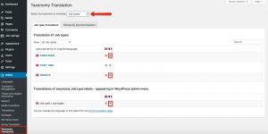

  1. Go to the WPML ->Taxonomy Translation page and select which taxonomies you need to translate from the drop-down menu.wpml and wp job manager
2. In our example, we chose to translate Job Types, but the following steps are also applicable for Tags and Job Categories. We have three job types: FREELANCE, PART-TIME, and REMOTE.
3. To translate them, simply click on the plus button located under the flag of the secondary language.
Clicking on the plus to translate
4. Again, the Translation Editor will appear. Translate your Job Type and click on Save.

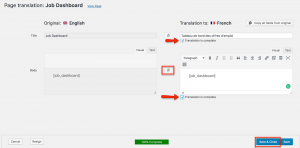

3. There are two things to do:
– Translate the title of the page into the secondary language.
– Click on the Copy icon to copy the shortcode into the secondary language.
using wpml to translate WP Job Manager
Copy button in the WPML Translation Editor
